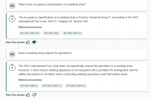

IBC 2018. Just to make sure I am looking at this correct. No sprinkler system is required in an F-2 occupancy (Weld Shop) which is 15000 square feet. Thanks
On a different thread, we discussed trying the AI navigator out. I thought this question would be an interesting test of it.
As you can see, the answer regarding the classification did not generate whether it was an F1 or F2. The answer also does not consider any amounts of gases which might needed to be determined for an H consideration. However, by answering the 2nd question it would appear that it is classifying a welding shop as an F2.
