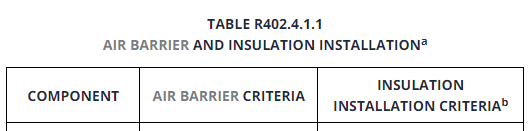

Faced or Unfaced(?) insulation with air barrier behind showers located along exterior walls?

Faced or Unfaced(?) insulation with air barrier behind showers located along exterior walls? What are yall's thoughts? Thanks!
I've usually seen paper faced insulation and a Tyvek or 3/16" plywood air barrier. It's probably best to slit the insulation facing, but it isn't that much of a vapor barrier anyway, especially if the insulation flanges are stapled to the sides of the studs.
