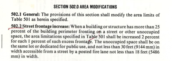

That's interesting. The open yard increase has been in the code for decades, and older versions of the ICBO Handbook said that better fire department access was a benefit, and access is a "good idea", but NOT a code requirement. I wonder when the commentary changed? And if it is critical to provide an apparatus access road in the yard, and not merely "have access from" a street/fire lane to the edge of the yard, why didn't the code say this explicitly?

I'm in the northeast, so pre-ICC we used the BOCA codes. I have all our old codes, but no commentaries or handbooks. All I can say is as far back as 1972, when I graduated from architecture school and started working full-time as an architect, it was understood that in order to qualify for an increase in allowable tabular area, the open space had to be suitable for firefighting operations. For example, if the back of a building had 100 feet to the rear property line but two feet away from the building it started to slope down at a ridiculous angle -- it couldn't be counted as excess open perimeter for purposes of area increases. The same applied if it was thickly forested and the owner declined to cut down trees and grade the site for a sufficient distance away from the building to allow firefighting operations.
My old BOCA codes are in storage in the dungeon, but I'm fairly certain that in BOCA the open space and access thereto were a requirement, not just "a good idea."
From the same 1995 Handbook, here they think that a flood control channel would make a reasonable yard - - clearly not worried about fire vehicle access:
In BOCA days of old, if we had any question regarding the suitability of an open space we would consult the fire marshal and fire chief. If they were willing to accept it as suitable for fire department access (which was the intent of the provision), we would feel comfortable using it.
More recently, under a previous edition of the IBC, a museum wanted to build an addition and needed to use the excess frontage provision to be able to meet the area limitations. The rear of the building fronted ("reared"?) on an interstate highway ramp, which is certainly a public way. The fire department said there was no way they were going to stage their vehicles on a highway ramp to fight a fire in an adjacent building. No increase allowed.
