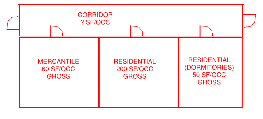

Figuring out SF/OCC of a corridor with services multiple uses.

Per TABLE 1004.1.2 MAXIMUM FLOOR AREA ALLOWANCES PER OCCUPANT, what would the SF/OCC be in the following condition?
My best answer: Whatever you can get the AHJ to accept.
Actually, I would use whatever the major occupancy is.
BTW, regarding dormitories, the occupant load factor is really for densely occupied buildings (think old-style military barracks or college dorms with 2 to 4 students in a sleeping unit with no kitchen and only community restrooms and showers. What is commonly built for today’s dormitories are actually apartments (dwelling units) with private baths, a kitchen, and a common living area. I’ve done many of these projects and have used the standard “residential” occupant load factor since they are really apartments and not a dormitory, even though they are occupied by students only.
More a general question, as I was trying to tease out how to determine the load from a corridor that serves multiple uses.
Seems like for exiting and rating add them all up.
There are a few more times where the number actually matters.
“Gross area” includes corridors, so an occupant load factor applied to the corridor would be applicable in this situation. However, the question is which occupant load factor. That is why I responded to use the occupant load factor for the major use of the building. If the building only included a small area of mercantile and apartments and the rest of the building was all dormitory, then the dormitory occupant load factor, in my opinion, would be applied to the corridor.
