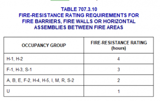

Is there an S1 use in the plaza? Might need to be 3hr......Unless they cleared that up....

707.3.10 Fire areas. The fire barriers or horizontal
assemblies, or both, separating a single occupancy into
different fire areas shall have a fire-resistance rating of
not less than that indicated in Table 707.3.10. The fire barriers
or horizontal assemblies, or both, separating fire
areas of mixed occupancies shall have a fire-resistance
rating of not less than the highest value indicated in Table
707.3.10 for the occupancies under consideration.
The restaurant it self is separated from the rest of the building with a 2-hour fire barrier creating separate fire areas,
If the exterior wall is 2-hour rated then they should be 2 separate and distinct fire areas. Different fire areas have the same roof over them. Rating the exterior wall would meet the intent of the code
The fire barriers, fire walls or horizontal assemblies, or combination thereof, separating a single occupancy into different fire areas shall have a fire-resistance rating of not less than that indicated in Table 707.3.10. The fire barriers, fire walls or horizontal assemblies, or combination thereof, separating fire areas of mixed occupancies shall have a fire-resistance rating of not less than the highest value indicated in Table 707.3.10 for the occupancies under consideration.
