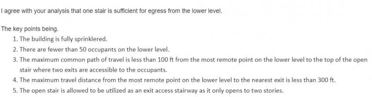

I’m going through a similar situation for the lower level of a branch reno. Below grade, no windows or doors to the exterior. My AoR has a PE on staff who is their fire protection lead, and this is his determination for our situation.

So in your situation, your stair is an open stair that is not enclosed, so the circulation through the stair was considered as part of the maximum common path of egress, but my question is: if the stair is enclosed completely with a fire rated enclosure, then do you consider the circulation through that fire rated enclosure as part of the common path of egress? or do you stop at the fire rated enclosure door?
...if the stair is enclosed completely with a fire rated enclosure, then do you consider the circulation through that fire rated enclosure as part of the common path of egress? or do you stop at the fire rated enclosure door?
By definition of CPET, you would never include an interior exit stairway in the measurement. Once you reach an exit, the CPET ends.

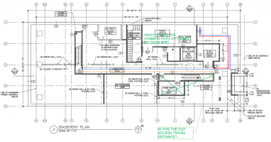

I have similar situation in my current project and I am confused with what is the CPET and Exit Access Travel. Can I eliminate ST04 and just maintain ST03 with one exit out of the basement? Occupancy is under 29 and fully sprinklered.
I think your blue line would have to be <75'...1006.3.4 (2)..But you might get an increase to 100'
Yes, correct, 100 feet when fully sprinklered. Unfortunate, with the current configuration I would be over the 100 feet limit.
