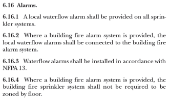

I found a copy of NFPA 13R-2010, which may actually have been in effect in Massachusetts in 2012. A waterflow alarm is required. It does not have to be connected to the fire department.

Thank you. That takes care of 1 question. Now some speculation on why wouldn't it be working? (assume from day 1)
Also they called it "critical". Is that just hyperbole? Either it works or it doesn't. Is there a grading system of not-working?

I have no idea, and I doubt that anyone can answer that from looking at a photograph.
There is no sliding scale. The waterflow alarm has one job -- to set off an alarm if water flows in the system. It either works, or it doesn't.
