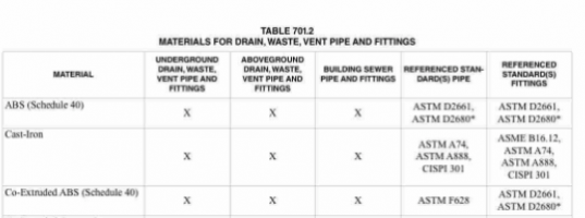

I just got a call from a construction supply yard asking if "Foam Core" ABS is permitted instead of "regular" ABS. I've never seen it or heard of it, apparently it's an East Coast product. Is it treated the same a ABS from a code enforcement standpoint? Thanks.
According to google, yes that is the same. Problem is code doesn't list either of those as an allowable material for DWV piping. My book lists ABS (schedule 40), Co-Extruded ABS (schedule 40), or Co-Extruded Composite (schedule 40) among the listed "approved" materials. I'm leaning towards allowing it but just looking for anybody with experience using, or approving this product. Thanks.
FYI, Foam Core is typically the same thing as Co-Extruded.
Now, to get to it... here is an example material submittal form from Charlotte Pipe and Foundry.
For acceptable materials for DWV/sewer (if you use the UPC), see Table 701.2 (below)
Now, putting the two images above together, we can see that the Charlotte Pipe and Foundry Foam Core ABS is tested to ASTM D2661 (fittings) and F628 (pipe). The same ASTM are referenced for Co-Extruded ABS under Table 701.2.
Therefore, if following the UPC, no issue. Can not definitively say the IPC is the same, but I would not suspect any difference.
2018 IPC, Coextruded ABS is an approved material
