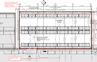

I have an existing laboratory facility (original classification of B), built in 1997, type II-N. They are proposing a one-story addition of a 3,400sf² "free-standing" refrigerated warehouse. The manufactured cooler walls and ceiling are insulated with foam plastic. So because it contains foam plastic in a cooler > 1,000sf² (IBC 603.1 #26) I see this as a V-B addition, abutted to the main structure with 0' FSD between the two, requiring a 1-hr exterior wall per t602. However, IBC 2603.5 for foam plastic in exterior walls contains language that confuses me. It has specific language for exterior walls of I,II,III, or IV walls over one story which wouldn't apply? It also has language for any exterior wall of type V construction. Does this section negate 603 and only require the provisions of 2603.2 for labeling, 2603.2 for surface burning characteristics and 603.4 for thermal barriers?
Put more simply:
Is a 3,400sf² panelized refrigerated warehouse wall with urethane foam insulation a type V building?
If so, and it is placed within 1' of an existing II-N (II-B) building, then does t602 apply and both buildings must have rated exterior walls? (The existing building would exceed the allowable area for type V)

So as I have been pondering this I have come to start to believe that this is a type II construction, allowed to have foam plastic in accordance with 2603.5 as long as that plastic meets 2603.2 for labeling, 2603.2 for surface burning characteristics and 603.4 for thermal barriers.
That being the case, as a type II-B, it is the same as the existing building and could therefore be considered as part of the same building, and not require exterior walls per t602.
Strike that last post. Since it is type II it must meet 2603.5.1 thru 2603.5.7.
Could not both buildings be considered portions of one building per 503.1.2?
My (very limited) experience with modular "equipment" like this is that it's permitted and inspected by a State agency, at the manufacturers facility. Locally, an Owner would only need pull a foundation permit.
