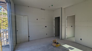

Here is a summary of my question. this is my first post but I have been searching this forum for a while and it's been great, very helpful!
I am building a home here in Southern Califonria as an Owner Builder.
I called for my lath inspection last month, when the inspector called me he asked if I was done with drywall. I told him no, I was just starting drywall but wanted to start the stucco if possible and that was why I was calling for the lath inspection. He told me to "finish the drywall" because they do the lath and drywall inspection at the same time. I took that as I needed to "finish" the drywall.
Today when the inspector showed up for my lath and drywall inspection the first thing he asked me was, "why did you finish the drywall?"
The inspector explained that the drywall inspection is to verify screws. He said he could not see all the screws. He said my lath was fine but to reach out to the inspector who told me to "finish the drywall" as that was the inspector that told me to finish and he had to deal with it.
Have you ever dealt with a situation like this?
I took hundreds of photos of the framing before drywall because I will use those down the road for hanging TV's, adding electrical if needed, etc. But I only took 30-40 photos of the drywall that shows the nails.
I am in the process of putting new screws in, it's a pain but it is what it is. I can mud over the screws quickly and move on. It's a couple extra days of work and a good learning lesson for me.
I think the worst part about the situation is the lack of communication with the inspectors and building department. I call the inspection hotline for a question and rarely get a call back or speak to a live voice. I leave comments in my inspection requests that never get read with questions I have. Nobody bothers to return a phone call or an email or respond.
But I am posting here wondering if you had to deal with a similar situation before?
Attaching a few of the photos I have before we started taping and texturing.

Congratulations on the new house. And you got lucky when you found this forum. While the forum is not a DIY site I suspect that a great many DIY'rs come here. I've built a thing or two, been an inspector for a long time and I get schooled here just like you... well maybe not just like you but you get the idea.
So to your question. I seems that you've run into two misinformed inspectors and being a novice you didn't know when to stop. The first inspector should not have told you to finish the drywall prior to a lath inspection and then there's the insulation to consider. The lath inspection includes me checking for shiners. Shiners are nails or staples that didn't hit a framing member or did hit a cable or pipe. Theoretically the insulation should not be in place yet but I don't have a problem pulling some of it out to see if you missed....or hit. I don't know about San Diego but a large part of California now requires a HERS rater to inspect the insulation. I'm betting you didn't get that.
The second inspector is wound up about not seeing the screws. The lids is where it matters. It is rare that drywall fails inspection... it does happen. You have a boat load of pictures. What should cause him to be concerned is the shiners and insulation that he can't see.
In the long run, if you have to add screws for an inspection... oh well, in the grand scheme of things it could be sooo much worse.
IMHO That inspector needs to attend some customer service training seminars. Telling you to call the other inspector sounds like middle school girl drama.
Since you have plenty of photos verifying the work was done and meets the intent of the code, he could have approved it right then if he was aware of the photos you have.

Gypsum screw assemblies are not a required inspection unless it is part of a fire assembly or structural.
110.3.5 Lath, gypsum board and gypsum panel product inspection.
Exception: Gypsum board and gypsum panel products that are not part of a fire-resistance-rated assembly or a structural assembly.

ONE OPTION: Meet the inspector and use a stud finder that also detects metal to show the screw pattern. Have the inspector select the areas, so they will see the fasteners are there.
Drywall inspection results in one of three outcomes. It all passes. There are a few screws too close to an edge and a few missing screws. The work is screwed with a over-driven screws. The OP has plenty of pictures.
The inspector can find out who did the work and based on how the rest of the job looks, make a decision. If the inspector is not 100% comfortable he/she/they can ask for additional screws.
