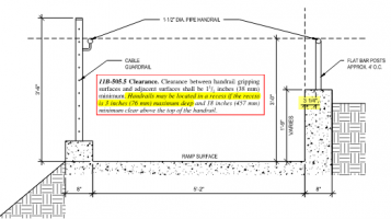

Handrails - limit on lateral distance from walking surface?
nealderidder
Sawhorse
Dec 7, 2010
399
Sacramento, CA
Good Morning all. I'm pondering some shop drawings and came across something I'm not sure about. There are plenty of regulations around handrails. Things like height, diameter, graspability, projection limits etc. But I'm not seeing a limit on how far away from the walking surface a handrail can be. There is certainly a practical limit, but is there any code limit? I'm talking about the 3-1/4" dimension on the attached. Is 3.25" too far? How about 6" or 8"?

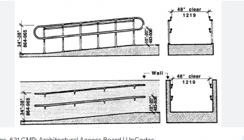

Oh yeah, good one Mark. I could nitpick that and say - 10" to the inside face of handrail? outside face? center?
But that 10" max does give me something to hang my hat on. Thanks!
I believe one of our guys submitted a 2024 change to put a dimension on it, but I do not remember what...somewhere between 4" and 9"
Those are ADA reaching distances and A117.1 as noted in post #5 a little there is nothing that addresses this issue on stairs and ramps specifically within any published model code of the ICC.
However in the Part "A" cycle more than a few proposal where submitted to establish a range, they were disapproved during committee action hearings, but a single version was approved at the final action hearings in Pittsburgh. I have to look up the specific code change, however that information and documentation will be published in the 2024 IBC, and as thus is coming but not currently adopted by any AHJ I am currently aware of with a local modification.
If this is a ramp where is the lower rail?

Accessibility requirements drive the lower rail, unless for some reason this is not on an accessible route
Neal, since you are located in Sacramento, I assume that this is a California project. CBC 11B-505.5 places limits on how far away a handrail can be "recessed" away from the walking surface. I've superimposed it on your original sketch:
  • Like
Reactions: tbz
? Yikes,
So Cali has added in a modification to chapter 11 accessibility section, how is it applied to areas outside of chapter 11?
I guess I am wondering why they didn't just drop it in chapter 10?
Nice to know this modification is out there though, was news to me.
The wording is a little off also for interpretation, as it says the recess can only be 3-inches, not the distance to the closest point of the handrail.
Symantec's I know, but questionable.
When the code is silent, we look at it from a different perspective using intent and purpose.
Given the minimum required width is provided between the handrails. (2018 IBC, Secdtion 1012.5.1)
and given that "Projections into the required width of aisles, stairways and ramps at each side shall not exceed 4 1/2 inches at or below the handrail (per IBC 1014.8), we allow no more than 4.5".
