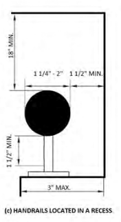

I agree that California's additional language is vague. It appears to me that they tried to strap on the detail from CBC's 11A, figure 11A-6B(c), which applies to private housing, and which looks like this:
Again, it's still a confusing-looking detail. But perhaps a clearer way to state the intent is:
  • Handrails should be provided with min 1.5" additional finger/knuckle space beyond the outside edge of the handrail
  • At no point should the outer extent of that 1.5" additional finger/knuckle space be more than 3" away from the walking surface of the ramp.
To put it another way, if this project is under California jurisdiction, and the detail is showing 1.5" O.D. handrails, then the inside face of the handrail needs to vertically align with the edge of the ramp walking surface below.

I get the intent but just wondering the thought process for the wording in 11B-505.5 Clearance
Using the language based of the verb "IN",
"Handrails may be located in a recess if the recess is 3 inches (76 mm) maximum deep and ...."
Then the use of the noun recess which is more about a restrictive confined area than an open setting like the OP,
I am questioning for informational reasons only how the governing body defined this wording in the reason statement for justification and commentary.
You have any background links one might find on this for Cali? Again for knowledge not challenging.

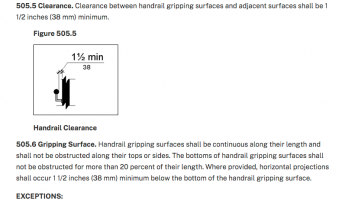

I have no background links, and did not participate in the adoption of that additional language that CA added to the ADA Standards when CA created CBC-11B.
So, all I can do is speculate and extrapolate form CBC 11A, so my thoughts aren't worth much without the archival research to back it up.
For most of us, we see the noun "recess" and think "alcove".
In my own speculation (via extrapolating from CBC 11A), I think the phrase "setback from the path of travel surface" would have been more useful (in the California language) to describe the distance from the path-of-travel surface to the handrail; and then measure it to the outside face of the handrail.
It would also be much more helpful to provide a separate paragraph called "handrails in a a recessed alcove", or something like that.

My interpretation of this passage from the 2010 ADA is that you cannot have the handrail inset over the thickness of that wall next to the ramp. It seems to me that the wall is a continuous obstruction to the bottom of the handrail that exceeds the 1-1/2" minimum obstruction depth allowed. Also, from a common sense point of view, anyone who has difficulty raising and extending their arm to the side will find it hard to reach over that wall and grab the handrail, or what if they need to bear weight on the handrail? Having the wall right there makes it very difficult.
