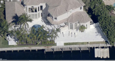

Handrails or No Handrails?
I would say yes also. Those stairs serve egress from the residence to a yard/public way. See R311.1
Once the step out onto the porch, they may already be in the yard. So R311.1 does not answer the question of whether steps that are located in a yard are part of the means of egress system.
311.7 gets closer to clarifying it, by saying "where required or provided", as noted by SteveRay.
To fully answer the question, you need to go to:
R311.3.1 Floor Elevations at the Required Egress Doors
Landings or finished floors at the required egress door shall be not more than 11/2 inches (38 mm) lower than the top of the threshold.
Exception: The landing or floor on the exterior side shall be not more than 73/4 inches (196 mm) below the top of the threshold.
Where exterior landings or floors serving the required egress door are not at grade, they shall be provided with access to grade by means of a ramp in accordance with Section R311.8 or a stairway in accordance with Section R311.7.
311.7.8 than discusses handrail requirements at 4 or more risers, which is shown in post #1.

If the concrete patio was poured right to the edge of the wood dock and there was no grass between raise patio and the concrete bulkhead and wood dock I would think harder about the possibility of the patio being the yard, but this projects photographs clearly show 4 risers down to the grade level.
As built a handrail IMO per the FL Residential building code requires (1) handrail be installed on each of the flights of stairs that Jar has posted.
for the rear flight if they are dead set on not installing a handrail, make the first tread down a landing and turn the flight left or right and descend down 3 risers and eliminate the requirement.
Or they can enlarge the bottom tread to be the minimum size for a landing and then again, now 3 risers no handrail required.
As to the front, extend the bottom tread out to minimum landing size and then again, no handrails, but as is, install the handrail.
On a home that size on the water like that, if they didn't want handrails the designer should have done a better job of preparing the plans to avoid having 4 risers.
If the designer did their job to be 3 or less risers and the builder messed up, let the owner take it out on the builder.
But what is there is a no go.

How is that a pool deck? It looks to me like a porch or deck overlooking a private dock on a public waterway. It doesn't appear to meet any of the exceptions listed in R311.7. Therefore, R311.7.8 applies and at least one handrail is required.
Because you can't see the inground pool between the house and the steps that is there. Look from this angle.

We can all agree there are 4 risers on each flight shown in the photos in post #1

So the way I see it from 1,000 miles away over a small screen in the middle on nowhere, non-compliance until a compliant handrail is installed on each flight.
From 2000miles away, adding my 2 cents:
If the handrail omission was not merely an oversight, my guess is that the designer was avoiding it in order to create some unobstructed view from the living room to the water, with the deck edge forming a border / horizon line dropoff, similar to an “infinity pool” effect.
The lawn also appears to be sloped, so as to avoid a 30”+ high edge dropoff that triggers a guardrail along the deck.
They could instead really embrace the stair handrail concept, integrating it into the architecture - - perhaps a nautical flagpole or lamp post as a newel post termination at the top?
I stand corrected. The only side that goes to grade, forces you to go through a gate on picture right. The other side is also a 24" dropoff.
Here is the question if something happened where you wanted to get out and away from the house from one of all those doors leading on to that patio, and even if you were already on the patio and then wanted to get off the very large rear elevated patio where do you believe the traffic would go during the exiting?
From what I can see in the picture posted it looks to me that over 80%+/- of the edge of the raised patio is more than 7.75" above grade, and the maybe aprox. 20%, and that is being generous, is hidden from anyone ever knowing to go that way, and besides that the exposed stair flight is the natural way to travel too and from the boat dock, not the gate at 3 o-clock out of sight or even used for access to the dock.
Here is a question, If you had a rear wooden deck 40 foot wide across the back of a home, 15 projected away, and on the left side was a stair flight down 4 risers to grade, and then 40 feet away on the opposite side of the deck it was at grade, would you not require the handrail down on that one side?
The STAIR FLIGHT is CONNECTED to the RAISED patio.

So to your question, no I don't consider the hidden part of the one small corner of the patio at grade with the current layout of the home.

This is an excellent evaluation of the situation. Thanks for taking the time to write this one up. I hope everyone else appreciates it.
Now let's add some context to the photos to take this to another level.
This was an existing home with a CO. The stairs were not added recently, they were part of the original build 20 years ago. There was a permit to replace the pavers in the back with the material you see now. That is what the permit was for, pavers on the patio and around the pool and of course cover the existing stairs. How does that affect anyone's opinion?
You say the stairs existed previously but the pavers are new. Yet they both appear to be the same finish material. Are you telling us that the stairs previously existed with a different finished surface, and they have recently been resurfaced with a new material to match the new deck pavers?
Also, when the stair was first built years ago, did they comply with the applicable code at that time?
