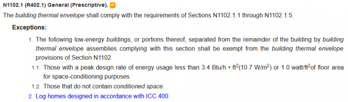

I am building a home with a heated garage. The garage is insulated well below prescriptive code requirements and of course the garage door cannot meet fenestration requirements. However, the customer wants to install a PTAC unit in the garage to make it more comfortable, but not to the temperatures required for conditioned space. The plan reviewer says that the installation of the PTAC would violate the following section of the code because it would be considered “conditioned space”.
The IRC defines conditioned space as follows:
I would argue that the garage is certainly not within the “building thermal envelope” and is therefore not “conditioned space”.
As you can see, the two definitions rely on each other. I’m pretty sure I got scolded for that in English class at one time or another.
Another strange issue is that as written N1102.1 only applies to homes using the Prescriptive Compliance Option. Even though I am using the Performance Compliance Option, the official still insists it is in violation.
I find it hard to believe that this is the intent of the code.

Using '21 IECC R502, it requires full compliance with the code. So, fully comply with R402.2.12 which has lower required R-values for heated garages, maybe that helps. Then fully comply with R402.3.5 which allows for lower fenestration requirements, maybe that helps. I thought there was something for the slab on grade insulation but I can't find it. Maybe someone else knows where it is or where it went. Worst case, add some external slab insulation if that exception can't be found, unless you are in zones 0,1,2,3 or are in a heavy termite zone. Maybe it is easier to add blown insulation in the attic for some trade-offs? Maybe a REScheck can help.

1102.2.12 allows for lower insulation values for heated garages if separated from conditioned space (the house). Table 1102.4.1.1 requires air sealing between garages and conditioned space. ACCA Manual J also requires separation between garages and conditioned space. The heating and cooling load calcs in Manual J are for occupied space, not the garage so there is not required minimum/maximum temp you have to maintain. Because of this, you can size the equipment in the garage to meet whatever setpoint you pick.
In my mind, all of these imply that conditioned space is intended to mean the dwelling unit.

Thank you all for your excellent advise. I had already contemplated e hilton's method, but I still need to frame an opening for the PTAC, trim around it, etc. We are in CZ-4, 2018 code. I think sifu and klarenbeek's solution should work. I have successfully used future code versions before to justify things and I think it will work here. Below is the verbiage from the 2021. They added heated garage to sunrooms.
These are the exact insulation amounts we planned to use and the wall between the home and garage is totally compliant and airtight. The other curious part of this code that I don't understand is that these sections only apply to the Prescriptive Method even in the 2021 as is stated in the following section. I must assume this is an oversight by the ICC:
