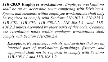

ADA 203.9 covers something called "employee work areas".
CBC 11B-203.9 exceeds ADA in that it adds the idea of "employee workstations", and it says that the workstations need to be on an accessible route.
So in the case of the OP's question: the equipment (tractors, etc.) don't need to be accessible themselves; however, DSA might consider the lawnmower / tractor storage to be a type of "workstation" and thus require an accessible path of travel to that area, or at least to "common use circulation paths".
