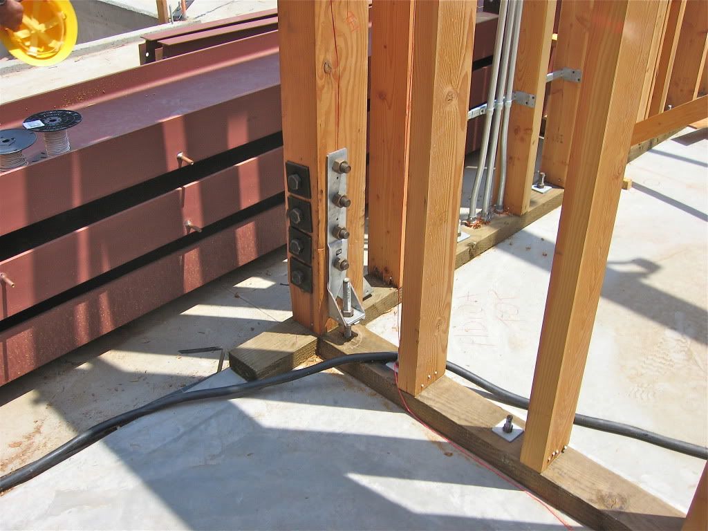

Is this what the engineer had in mind?

Need to really look at the structural plans..... Don't think a sane Engineer would ever specify two HD's on the same post/column/corner.
I was the superintendent on the RiverPointe building in Bend in the mid 80's. The structural plans called for two identical hold downs on a dozen six by six corner studs. That's how I did it. Everybody seemed happy with it.

What about Section R403.1.6, from the `06 IRC?

Me thinks that the inside "hold down" is too close to the sill plate end.

If it was a hold down designed to hold down that wall/sole plate it would be too close. But if you follow the orange string down to the sole plate you will see the anchor bolt for that wall. It's almost completely hidden by the stud.

I think the 4 bright bolts split the 4x corner stud, so the 4 dark bolts are there only to hold the two halves together at each bright bolt location. See the split above the strap?
nah, look at the bottom across from the the "dark" bolts, there is a hold down there. If the engineer buys off on it, move on unless your can prove them wrong.
