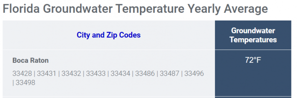

It's not which is why we don't make a big deal about it. The main problem is that the block gets so hot, it heats the cold water.
I have encountered a heating issue with pipe in attics and on the exterior of the building. It can be significant. In your case the furred walls limit your choices. A thermal break might help. What do they do to mitigate the problem?
If the CMU gets that hot why is there not a better insulation method?
The water down there is already hot right out of the ground.
Hurricanes, alligators, pythons, bugs the size of dinner plates, more lightning strikes than anywhere else on Earth and now this…. The average Florida H/O insurance policy is $6000 for a reason.
There is. It's called framing the inside wall and not just using PT furring strips. High-end homes definitely use metal framing on exterior walls but the other 98% of the homeowners get furring strips.
