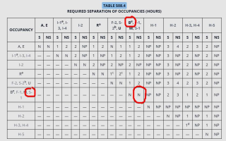

If you want to separate (B) from (S-1) per the following table, do you interpret it as it needs to be separated, but the separation is 0 rated?
Or do you interpret it as it doesn't need a separation at all (that is no physical barrier at all)?
I ask because I have a type VB where I'd like to separate these 2 occupancies, so the (B) can be 2 stories, and the (S-1) can be 1 story.
If they were nonseparated, the entire building would have to be 1 story. Do you see my confusion? :)The following code snippets adds to the confusion.

Thank you, but i'm still don't quite understand, per the following, i thought if you separated occupancies per Section 508, that each occupancy area could realize their individually allowed number of stories.
Again, perhaps my interpretation is wrong.
"In a building containing mixed occupancies in accordance with Section 508, no individual occupancy shall exceed the height and number of story limits specified in this section for the applicable occupancies."
Thank you for your guidance.
Yes, that is correct. You are treating them as a single building (therefore no fire wall is required) that has separated occupancies per 508.

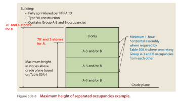

My understanding of what you want is:
1. Type VB, unsprinklered building.
2. S-1 on ground floor.
3. B on second floor.
1. Because you want a two-story building and S-1 is limited to 1-story per Table 504.4, you cannot use nonseparated occupancy per 508.3.2 (entire building must meet requirements of the most restrictive occupancy in the building.)
2. You can use separated occupancies as long as S-1 stays on the first floor (the maximum height per Table 504.4), you then need to separate S-1 and B per Table 508.4.
If this is the same project we’ve been talking about on a different thread then your stairs will need to be enclosed and rated because you’ll be penetrating the horizontal assembly between S-1 on the first floor and B on the second floor. [Edit. This is incorrect, no separation required per Table 508.4, see #10.]

Here’s an image from the 2018 IBC Illustrated Handbook illustrating the concept, the two notes in red are my additions:

Even if it's not considered an incidental occupancy isn't separation between a B and S-1 - zero rated, per 508.4 (that is, No separation requirement)?
Yes, that’s correct, I forgot your comment about that in #1 and didn’t check it myself before I said you’d need a stair. Table 508.4 says for B and S-1 you need “N” which mean no separation required, you can have them open to each other (literally nothing separating them) or any non-rated construction. Therefore no rated stair is required.
