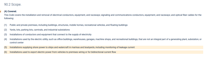

(Don't know what California does, this is what our code says)
2024 IEBC 302.3
Materials already in use in a building in compliance with requirements or approvals in effect at the time of their erection or installation shall be permitted to remain in use unless determined by the code official to be unsafe.
UNSAFE.
Buildings, structures or equipment that are unsanitary, or that are deficient due to inadequate means of egress facilities, inadequate light and ventilation, or that constitute a fire hazard, or in which the structure or individual structural members meet the definition of “Dangerous,” or that are otherwise dangerous to human life or the public welfare, or that involve illegal or improper occupancy or inadequate maintenance shall be deemed unsafe. A vacant structure that is not secured against entry shall be deemed unsafe.
"Unsafe" is the nuclear option. Unless you have scorch marks or melted wires at or around these lamps, I don't think you are to that point yet. A question about the listing of a product does not constitute an "unsafe condition". Otherwise, they are allowed to remain as-is. There is nothing in the NEC that would address the inspector's concerns.

NEC Sec. 83-5. Existing Installations. No provision of this Code shall be deemed to require a change in any portion of electrical systems or any other work regulated by this Code in or on an existing building or lot when such work was installed and is maintained in accordance with law in effect prior to the effective date of this Code, except when any such electrical systems or other work regulated by this Code is determined by the Chief Electrical Inspector to be in fact dangerous, unsafe, or a nuisance, and a menace to life, health or property.
I think that is in an appendix or whatever NFPA calls it...But Yeah....
Found something similar in city of LA - in their municipal code, but couldn't find it on UpCodes:
SEC. 93.0109. EXISTING CONSTRUCTION.
(Amended by Ord. No. 185,587, Eff. 7/16/18.)
Except as specified in LAMC Section 93.0111 and LAMC Section 93.0311(f), nothing contained in this Code shall be construed to curtail the uses of, nor to require any person to reinstall, reconstruct, alter, change or remove any electric wiring or equipment which had complied with the laws and regulations in effect at the time of installation.
