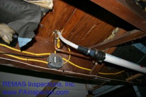

It's always nice to know why the DW drain connection is not correct:
2015 IRC
P2717.2 Sink and dishwasher.
The combined discharge from a dishwasher and a one- or two-compartment sink, with or without a food-waste disposer, shall be served by a trap of not less than 1-1/2 inches (38 mm) in outside diameter. The dishwasher discharge pipe or tubing shall rise to the underside of the counter and be fastened or otherwise held in that position before connecting to the head of the food-waste disposer or to a wye fitting in the sink tailpiece.
High loop island vent with the dishwasher discharging to the fixture trap.Now the next learning question is what do you do when the DW is in island that doesn't have a sink? (and the OPs photo may be just that situation.

manufacturers installation instructions overrides the code section.
No one is suggesting your OP picture would pass any code or manufactures installation instructionIn addition, you will not find mfg installation instructions that will allow this type of installation. Show me one.
Is your BO willing to accept something other than a listing?
We just got off on another rabbit trail
