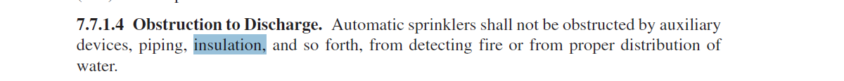

--Is wrapping exposed sprinkler pipe with tubular (foam) pipe insulation a) code approved and b) effective against condensation drips?
We operate an aged, 95% enclosed (full-enclosure cost prohibitive (code triggers)), public ice rink employing an overhead dry-pipe sprinkler system. Condensation collects on the iron pipe, dripping onto the ice at couplings. I seek to minimize the condensation drips. TIA.
NFPA 13 2007, a place to start, definitely do not use foam insulation, and the thicker the insulation in relation to the head may require the heads to be extended.
