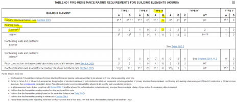

The question being: IF the primary frame "supports" the exterior wall is it part of the exterior wall and requires the same rating and where do we need to tweak that language....? I think the language in 704.10 has gotten it closer, but at the same time it hasn't nailed it, so the confusion is about equal...
In a PEMB the exterior wall is clearly not a load bearing wall:
[BS]WALL, LOAD-BEARING. Any wall meeting either of the following classifications:
  1. 1.Any metal or wood stud wall that supports more than 100 pounds per linear foot (1459 N/m) of vertical load in addition to its own weight.
  2. 2.Any masonry, concrete or mass timber wall that supports more than 200 pounds per linear foot (2919 N/m) of vertical load in addition to its own weight.
[BS]WALL, NONLOAD-BEARING. Any wall that is not a load-bearing wall.
They might be "within" if you consider supporting within.....
704.10 Exterior Structural Members
Load-bearing structural members located within the exterior walls or on the outside of a building or structure shall be provided with the highest fire-resistance rating as determined in accordance with the following:
  1. As required by Table 601 for the type of building element based on the type of construction of the building.
  2. As required by Table 601 for exterior bearing walls based on the type of construction.
  3. As required by Table 705.5 for exterior walls based on the fire separation distance.

Purlins are not load bearing walls, I agree.
They are however load bearing structural members. Take note of the language in 704.10.

The frames of a pre-engineered metal building are "inside" of the exterior walls, but they are certainly not "within" (contained inside of) the exterior walls. The exterior walls of a typical PEMB are a single, corrugated sheet of metal siding with some insulation stretched across the interior face. Unless you put something between the exterior skin and the interior facing of the insulation, there's nothing "within" the exterior walls.

So they would be primary frame or secondary members? Because primary frame would take us back to zero (T601) and secondary would require individual encasement....
[BG] SECONDARY STRUCTURAL MEMBERS. The following structural members shall be considered secondary members and not part of the primary structural frame:
  1. Structural members not having direct connections to the columns.
  2. Members of the floor construction and roof construction not having direct connections to the columns.
  3. Bracing members that are not designated as part of a primary structural frame or bearing wall.

Well, considering that almost every PEMB I have seen has the purlins attached directly to the columns, then I would say that purlins are not secondary structural members. Thus, they are part of the primary structure.
Thus, 704.3 may apply.
2021 IBC 704.3 Protection of the Primary Structural Frame Other Than Columns
Members of the primary structural frame other than columns that are required to have protection to achieve a fire-resistance rating and support more than two floors or one floor and roof, or support a load-bearing wall or a nonload-bearing wall more than two stories high, shall be provided individual encasement protection by protecting them on all sides for the full length, including connections to other structural members, with materials having the required fire-resistance rating.

But also note #3:
  1. Bracing members that are not designated as part of a primary structural frame or bearing wall.
So if the purlins do not brace the frame, they might meet #3......Just splitting hairs on individual encasement...Which would be ludicrous to build a slightly smaller building in some limited cases...That is what always gets me is the minor differences (If any) in H&A which seems like a ton of "give up" of the combustibles in IIIB vs. IIB....

Apologies for the poor quality of the photos. The old pages are starting to discolor, and my desk doesn't have the best lighting in the universe.

Steveray, I believe the 2 hour masonry exterior walls were meant to contain a fire to the building where it originated, and protect a building from fires in nearby buildings. Joists were firecut on the ends so they wouldn't pull the walls down when the interior burned and fell down.
Non-bearing exterior walls fire rating is dependent upon three things:
-construction type
-occupancy
-distance to nearby structures or property lines
See Table 705.5
For instance, if you have a zero-lot line Type IIIB building with a B occupancy, then 1 hour exterior fire rated wall along and within 10' of the property line.
If said wall is a structural bearing wall, then it needs to be a 2-hour fire rated wall per 601.
If you are confused as to what a "Primary Structure" is, its part of the structural frame. Check under Chapter 2 - Definitions:
[BS] BEARING WALL STRUCTURE: A building or other structure in which vertical loads from floors and roofs are primarily supported by walls.
[BG] PRIMARY STRUCTURAL FRAME. The primary structural frame shall include all of the following structural members:
  1. The columns.
  2. Structural members having direct connections to the columns, including girders, beams, trusses and spandrels.
  3. Members of the floor construction and roof construction having direct connections to the columns.
  4. Members that are essential to the vertical stability of the primary structural frame under gravity loading.
Edit - I believe you are thinking of Type IV / Heavy Timber construction. Type IV are min. 2-hour masonry load bearing exterior walls w/ timber framing on the interior.
Type IIIB is considered "standard construction."
