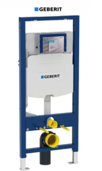

1 hour type V wood framed wall, uses 5/8" X to achieve fire rating.
Geberit wall-mounted toilet with concealed in-wall tank, which fits in the stud cavity, and a pushbutton flush plate ("actuator") that goes through the Type X gyp board with a square opening that is about 5.5" x 9.5"
Does this penetration of the actuator meet code for a 1 hour wall?
If not, how do we fix it? Fire putty? Line the stud bay with gyp board? (The metal carrier is supposed to attach directly to studs.)
