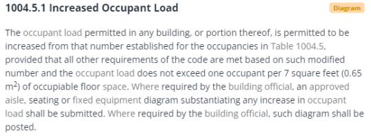

Thanks for posting this. Of course, Table 1004.5 is subject to the exceptions of 1004.5 and 1004.5.1, which are a reasonable concession to projects that are unique. My classic example, is the private fitness center that has an indoor basketball court for pickup games, maybe 10-20 people max actual occupancy on court and sidelines. They're not holding school assemblies in their gym, and the occupant load is reasonably lower.
