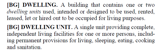

Is there a listing of examples of what does and doesn't qualify to meet the definition of a dwelling or sleeping unit that can or will be used all or part of the time as the occupant's place of abode?
Unfortunately the term "abode" is not defined in the building code.
Use of Type B units hinges on this definition.
Does a "place of abode" mean someone gets their mail?
Does it mean they have a cooking unit?
Does it simply mean there is a bed?
Online dictionary says it can mean a residence or a place of extended stay.

Will you post the definition you see

The word "abode" is used only in the definition for INTENDED TO BE OCCUPIED AS A RESIDENCE in both the IBC and ANSI A117.1. The use of intended to be occupied as a residence is only found in IBC Chapter 11.
I interpret intended to be occupied as a residence as a place where someone establishes permanent residence, so motels and hotels, hospitals, short-term care facilities, fire stations, etc. would not fall within this definition. The IBC does have a definition for short-term residential occupancies: transient. This is a dwelling unit or sleeping unit that is occupied for not more than 30 days. However, there are some extended-stay hotels, which would be considered "nontransient" since they may be occupied by people for more than 30 days. However, these types of places are not considered the occupants' permanent place of residence, or "abode." Extended-stay hotels are usually for employees on long work assignments or people on lengthy vacations.
Long-term care facilities, which may use sleeping units, would be considered places intended to be occupied as a residence since the occupants may live out the rest of their lives there.
Usually (but not in all cases) a permanent place of residence will necessitate moving one's own furnishings into the residence. Also, the occupant may receive their mail at the permanent place of residence.
So the saying, "If it looks like a duck, swims like a duck, and quacks like a duck, then it probably is a duck," applies here. If it looks like a place where someone would live permanently, then it is considered a place intended to be occupied as a residence.

What if I said this was I-1 occupancy? See: 1107.5.1.2
1107.5.1.2 Type B units. In structures with four or more dwelling units or sleeping units intended to be occupied as a residence, every dwelling unit and sleeping unit intended to be occupied as a residence shall be a Type B unit.
Chapter 2 Definitions
INTENDED TO BE OCCUPIED AS A RESIDENCE. This refers to a dwelling unit or sleeping unit that can or will be used all or part of the time as the occupant’s place of abode.
