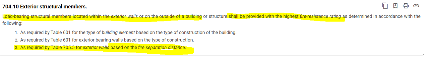

The proposed canopy straddles the property line between parcels owned by Owner A and Owner B. In fact, three of the columns are on one parcel and three are on the other parcel. Three of the columns are only about two feet from the property line, which means they need a fire-resistance rating. Naturally, the architects haven't considered this because they only looked at the lease line -- even though all the site and civil drawings clearly show the other property lines and identify them as property lines.

Unless you use Ex2, the building code does not do well with this...
706.1.1​
Any wall located on a lot line between adjacent buildings, which is used or adapted for joint service between the two buildings, shall be constructed as a fire wall in accordance with Section 706. Party walls shall be constructed without openings and shall create separate buildings.
Exceptions:
  1. 1.Openings in a party wall separating an anchor buildingand a mall shall be in accordance with Section 402.4.2.2.1.
  2. 2.Party walls and fire walls are not required on lot lines dividing a building for ownership purposes where the aggregate height and area of the portions of the building located on both sides of the lot line do not exceed the maximum height and area requirements of this code. For the building official’s review and approval, the official shall be provided with copies of dedicated access easements and contractual agreements that permit the owners of portions of the building located on either side of the lot line access to the other side for purposes of maintaining fire and life safety systems necessary for the operation of the building.
706.1.1​
Exceptions:
And this situation doesn't fit Exception #2 to 706.1.1 because there's no separation of ownership of the proposed canopy between two entities. The building and the canopy will be owned by the fast food company, and the land is owned by a pair of LLCs that are ultimately controlled by the same person.
Am confused, 706.1.1's base requirement is "Any wall located on a lot line . . . shall . . . " It doesn't say "Any portion of a structure located on a lot line . . ."
Does the canopy design include a wall located on a lot line? If not, what's the issue?
