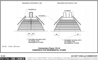

On monumental stairs, handrails shall be located along the most direct path of egress travel.
I take this to mean if the exit out of the building is centered on the monumental stairs then the handrail needs to be in the middle of the stairs and non are required along the edge as long as the OL does not exceed 60 inches.

The IBC commentary for 1014.9 also says:
"Monumental stairways are typically provided for architectural effect and may or may not be considered egress stairs."

1. Yes. However, per the smaller image from the Commentary, the handrails would still need to be located along the most direct path. If there is no discernable direct path (a wide-open area, for example), then the handrails could be located pretty much anywhere the designer would like them.
The code itself does not say that. Do you have a link or resource for the IBC commentary you mention? Because that would contradict Bill that it MUST be considered (although he may still be right that it SHOULD be considered), and supports RLGA that is not required for egress.
I talked our codes instructor in the department, and at a first thought he thinks that the monumental stair, if it is open in an atrium, should not be considered egress since it is not rated/protected like a dedicated fire stair, and so the governing code on an intermediate handrail is in a sense reversed. Code requires a minimum of 44" width to facilitate travel, so a stair would need to be 88" wide (2x44) before putting in an intermediate handrail, so as not to restrict the traffic flow.
