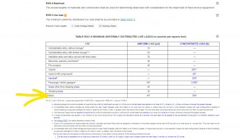

I am working on some deck stairs and while I see a bunch of stuff online that says the max space between stringers is 18" I am not successful finding the relevant IRC 2018 section if any. My stairs are 6' wide made of 2x6 planks and wish to use 3 risers but not sure if up to code.

This is why I am still a fan of the AWC's DCA-6 Manual, even though it is not a code, it is recognized and something you can always point back to as the standard you used in the absence of an answer in the IRC.

No, nothing in the IRC on exterior stairs that serve a deck. This is another reason why either the DCA-6 should have been referenced or brought into the IRC; however, it needed to be legal. It is a great reference on how to build a safe deck and stairs.
The DCA 6 provides the easiest way to prove you meet this requirement from the IRC. Other than this, the IRC has very little guidance on stair stringers.
