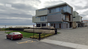

I have been on more than a few of these type projects after Irene and Sandy.
This is the closest I can come to theory off the top of my head, we worked on this property 3 times in 4 years.
Did the reno in the spring, then Irene messed up the original ground level home reno that fall.
Re-did the Reno the following spring
Then Sandy just hammered and left nothing standing but, the SAND that fall again, twice in the span of one year.
Then Client built this which sits 16ft up to the first floor level, then a second floor level.
Open parking under it with open stairway between elevator room and ground level storage room.
The first 2 reno's were IRC, this went IBC - R3
