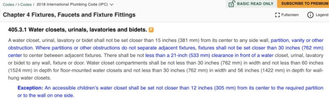

I'd like to add a utility/slop sink to be located in the space below a flight of stairs, near the garage. It's currently a closet with some radiant manifolds that aren't in use yet.
In the past, an inspector or contractor mentioned there was a related code violation with such an install. Something around head space may have been mentioned, but I've searched but cannot find any code surrounding clearances that would apply.
I do see:
But, was unable to find a definition for 'lavatory'... I'm not sure if that encompasses a utility sink.
Would an install in this space be code compliant? If not, please let me know the code reference.
I'm on IRC 2015, IPC 2015.
Thanks!!
