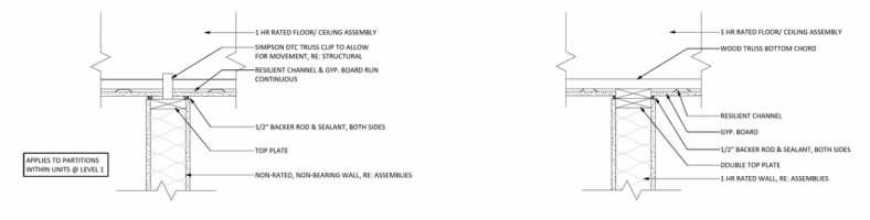

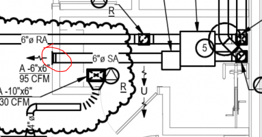

Walking final inspections with county inspector for this apartment building as the GC. There is a utility closet or "colorado closet" that has an unrated drop ceiling for housing duct connections to a an ERV. Inspector says he wants us to caulk (with like bathroom caulk not UL intumescent) around a supply grill in the parition wall inside the drop ceiling (see red circles in plan pics). When I challenge why this would fail a final building inspection for the unit he says the code says drafstopping is needed and that they can consider the concealed space part of the fire rated ceiling assembly.
I am I wrong to think this is crazy? like making up code? the wall has no design and rating, its studs and drywall. The UL listed floor truss ceiling assembly is continuous across the ceiling as seen in the framing connection details below.
I think it would be insane to cut drywall anywhere to get caulk around a supply grill for no reason. Anyone able to justfy this? It might hold up certifgicate of occupany and cost us money in punch repairs. I want to argue but some want to just comply as not to poke the bear in the BD. We have air leakage requirements in the IECC, but we already passed a blower door test and that concealed mechanical space is part of the apartment unit envelope anyway.
