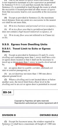

There is an existing house (older than 5 years) where a secondary suite was added in basement which has a bedroom on ground floor. There is a dedicated stairs with less than 6 risers for this room to go down to basement.
There are fire separations between the primary unit of the house and the new added secondary suite, and smoke alarms are interconnected, while these are not of interest of this post.
There is a window for the bedroom on ground floor which belongs to the secondary suite in the basement, is this bedroom required to have a secondary means of egress? (which can be achieved by using the window of this bedroom.)

It looks like that there is no need to have secondary means of egress since the travel from the bedroom down to basement exit is not more than 1 storey.

You are correct.
There are egress requirements from a bedroom, which is typically accomplished by a window, but could be a door. There is also such a thing as a combination room where there is a bedroom and an attached adjacent room as part of the bedroom if certain conditions are met - see OBC 9.5.1.4. In that case, egress can be accomplished through the combination room.
There are also requirements for the suite, which typically would just require the front door is treated as the exit, with exception of a three storey dwelling sitting on a full basement.
The IRC codes used in the US have specific requirements related to egress from basements (see ICE's post) that are not reflected in Canadian codes.

It looks to me that the removal of an egress window still allows occupants in bedroom 2 to go up or down not more than 1 storey to reach the basement level served by the basement walkout stairs, am I correct?
Ontario Building Code:
9.9.9.1. Travel Limit to Exits or Egress Doors
(1) Except as provided in Sentences (2) and (3), every dwelling unit containing more than 1 storey shall have exits or
egress doors located so that it shall not be necessary to travel up or down more than 1 storey to reach a level served by,
No, there is no interaction between 9.9.9. and 9.9.10.
9.9.9. is specific requirements related to egress from dwelling units as a whole. The intention of this section is to create an exception where an exit is not required on every single floor of a dwelling if certain conditions are met.
In contrast, 9.9.10. deals specifically with egress from bedrooms, typically located within a dwelling. The intention is to establish a requirement for egress windows and exceptions to this requirement.
If the intention of the code was that these two clauses were related, there would be language in each clause pointing to the other clause, however, there is not, so we must conclude that these clauses are to be interpreted in isolation of one another. i.e.: both requirements must be met and if they are in conflict, the more restrictive applies (this is in contrast to our American friends on this board, as the most specific applies in their case).
