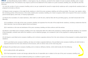

2023 CA Government Code 65852.22.
6)... accessory dwelling unit to include an efficiency kitchen, which shall include all of the following:
(A) A sink with a maximum waste line diameter of 1.5 inches.
(B) (A) A cooking facility with appliances that do not require electrical service greater than 120 volts, or natural or propane gas. appliances.
(C) (B) A food preparation counter and storage cabinets that are of reasonable size in relation to the size of the ...accessory dwelling unit.
The lines in red above abut 1.5" max drains and 120 volt max appliances are not found in CGC 65852.22.6.
https://leginfo.legislature.ca.gov/faces/codes_displaySection.xhtml?lawCode=GOV&sectionNum=65852.22.
CBC 202 defines a kitchen or kitchenette as a room, space or area with equipment for the preparation and cooking of food.
I've not found anything that defines "cooking", but in a number of discussion through the years, an informal consensus emerged that a cooking appliance conducts heat directly onto food. In other words, a microwave does not apply heat to the food, so it is not a cooking device. A single hot plate is a cooking device. An induction cooktop in conjunction with the right pans makes the pan bottom into a cooking device. A convection oven might be a cooking device, because it also happens to heat the metal tray upon which the food sits.
I do not claim this is any official definition, and somebody can probably shoot holes in this area.
In post #1, I believe the 5' kitchen has 2 appliances (cooktop and refrigerator), and it describes some storage, so it should qualify.
