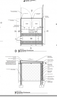

An architect submitted a revision to the approved drawings with this storage area added to the dumpster enclosure. Ohio building code has an exception for storage accessories up to 120 SF. This is 160 SF of enclosed area. So is it a building? It has lights but no mechanical - they just have a louver in the door and some vents along the roof line. I was going to consider it it a building on the same lot per 503. If it is a building what should I review - are there required ventilation rates? does the energy code apply?

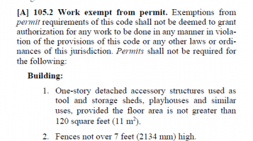

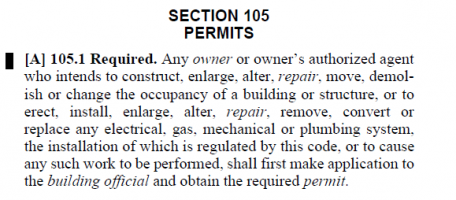

Not in the list of exempt from permitting 105.2
The structure has a zoning component, hopefully it is part of a plan for site development and meets any requirements for setback or other such issues.
Agreed, definitely a structure. To answer the original question, yes it's a building.

I would say that drawing shows a building, and the size is 460+ sf. Once they added on the storage space, the entire set of combined walls becomes the building.
