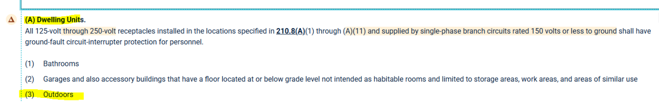

YES..and may be required....Is it allowed per code to have a 20 amp general purpose receptacle on a kitchen island or peninsula as long as it's more than 12" below the counter top?
Not whom, what. The Code should decide, not planners.Well if the city can decide that ypu are allowed just one kitchen, I reckon that they get to decide what is a kitchen. Out of curiosity, whom would you prefer make the judgement?
The Code hasn’t yet figured out what is a bedroom. The patio that I posted is one extreme that is not a kitchen and in Florida, if you tear open a package of Fig Newtons, you’re in a kitchen.Not whom, what. The Code should decide, not planners.
As well as all laundry areas, item (10) on the same list in 210.8(A) of the 2020 NEC. This was a change from the 2017 NEC, where 210.8(A) was limited to 15A and 20A receptacles. No moreAll outdoor receptacles already do...
Do they?All outdoor receptacles already do...
I got compliance pretty easy on the dryer circuit, it was the A/C condenser and later the ovens and ranges that got pushback - because they trip GFCI's because of high-frequency leakage currents that cannot be fixed in the field except by removing the GFCI protection.Wayne,
I picked up on that change NEC 2020 but not seeing the electricians protecting that 240V dryer circuit. (125-volt through 250-volt). Residential dryers fall in this range typically at 240V.
Are we seeing push back or compliance?
The dryer receptacle (which is 250V nominal, on a 240V nominal branch circuit) requires GFCI protection under 2020 NEC 210.8(A). So it sounds like you're seeing contractors and/or inspectors not being up to date on the 2020 NEC change.I picked up on that change NEC 2020 but not seeing the electricians protecting that 240V dryer circuit. (125-volt through 250-volt). Residential dryers fall in this range typically at 240V.

Does this island receptacle require AFCI, GFCI or both?
