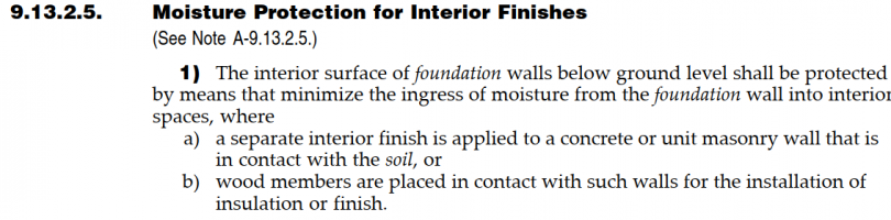

Interesting situation in our office this morning. A client is installing wood-frame walls in a basement, and is balking at the idea of isolating 2x4 walls - with 5.5" R20 insulation - from the foundation.
Code reference:
This leads to an interesting challenge that we thought about: what if the client built the interior stud walls so that neither the wood nor the insulation contacted the foundation? It could be argued that 9.13.2.5(1)(b) would no longer apply.
Thoughts?
Is there an air vapor barrier planned? Assuming masonry foundation wall with no insulation and probably not first class damp proofing in the ground side, I'd put a air vapor barrier - 10 mil at least - on wall, and then build wall inside that with anchors at floor and first floor joists, not through air barrier. Any moisture that gets into wall will dry to inside. Troweling mastic to wall before pressing air vapor barrier into it would be an improvement.
(I'm assuming he doesn't want to use foam - rigid or spray - or I'd probably start there - 2" foam fully adhered and seams sealed. Put studs inside that or just glue drywall to the foam.)
Yes, we typically had people offset the walls to avoid having to place moisture protection between the concrete wall and the wall framing.
To fit 5.5" R-20 insulation into a 2x4 wall without compressing the insulation (which would make it no longer R-20), the studs will need to be offset from the foundation wall by a minimum of 2 inches anyway. At that point, my concern would be the insulation wicking moisture out of the foundation, which would further compromise the insulation value.

1) Would still require vapour barrier on the warm side. Canadian codes allow for the interior of wood walls against foundation walls to "breathe" upwards. I'd use vapour barrier on both sides, myself. Or, like you say , go with foam.
I would never recommend a vapor nor air barrier on the inside of a wall against a foundation wall. Seems like recipe for mold and rot. In "breathing up", where does make up air come from? Do you put vents at inside bottom of wall?
The only way to use hygroscopic material like fiberglass against a foundation wall is with a great vapor barrier against the wall, like Tu-Tuff, preferably embedded in mastic. Or, flash and batt, with studs spaced out an 1", 2" of spray foam, and then batts.
But the wall has to be allowed to dry inward.

Can you point to the code section that specifies this?
9.25.3.1. requires an air barrier to prevent air leakage from the building into the wall cavity.
9.25.4.1. requires a vapor barrier to prevent moisture diffusion from the building into the wall cavity.
