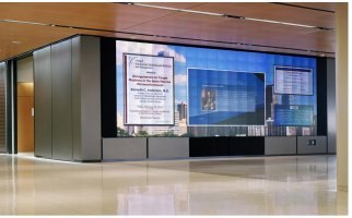

Yes. We installed what we called microtiles. Forgot the brand name. I think it was 6 rows x 9 columns of display units, just like what you used to see in the background of the NFL pregame shows. Never had a problem with pushback from inspectors. Installed 3 in Richmond, 2 in DC, and many more around the country.
This is an internet picture. You can see the grid pattern of individual tiles about 12”h x 14”w. Our displays were recessed into a wall similar to this.

nmonday, ...would the new wall & installation of the monitors
be initially reviewed under the 2018 Virginia Existing Bldg.
Code [ RE:
Section 601.2.2, Level 2, No. 1 & No. 3 ], which
leads to Section 602.3.1 to "comply with Ch. 8 of the VCC" ?
Also, IMO you may want to schedule an in-person meeting
with the Building Official to discuss the matter more in-depth
and [ possibly ] see if there are any exceptions.
