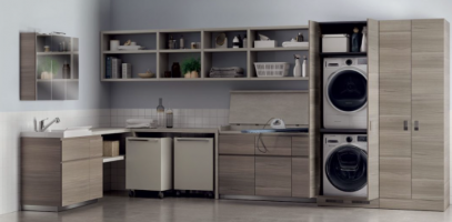

The IBC does not have a written definition of "room", when trying to define what constitutes a "laundry room".
IBC 202 has a definition of "space":
  • A definable area, such as, a room, toilet room, hall, assembly area, entrance, storage room, alcove, courtyard, or lobby."
Under that definition, all rooms have definable areas, but not all definable areas are required to be considered "rooms".
If the laundry appliances form a reasonably "definable area" that is less than 100 SF and is part of a hair salon that is 1000 SF, I would not consider the hair salon to be a "laundry room greater than 100 SF".
For example, I would consider the following image to be a "definable space" for laundry appliances without calling it a "room greater than 100SF":
The NFPA language also clarifies that NFPA's concern was for "bulk laundry" greater than 100 SF.
IMO it is reasonable to make a determination that a 1000 Sf hair salon will not be devoting 10% of its area to processing bulk laundry.
Of course, as mtlogcabin pointed out in post #13, the building official makes the final interpretation.
