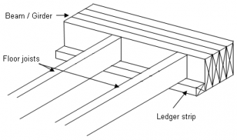

In my opinion, a ledger strip is nailed to side of a beam, like a 2x2 at bottom of an 8x12, to support 2x10 joists, which are toe nailed to beam. It's an option to joist hangers.
A ribbon strip is let into studs, and the joists sit on top and continue into the wall past the face of the studs.

In simple terms... this is what each looks like. Note that a ribbon board is let-in to the stud and joists are face nailed to the balloon framing. Whereas a ledger board is face-anchored (face-nail is not always permissible; subject to withdrawal) to either the rim joist or stud framing. As others have pointed out, requirements for minimum bearing area are different - ribbon board providing 0.75" plus face nailing within wall cavity and a ledger typically using joist hangers, but can be installed below joist and provide 1.5" bearing.
Ribbon board
Ledger board

I wish there was a picture but it sounds like a 2x4 or close anchored to face of studs and joists just sitting on it. I believe this is not a good connection and do not recommend it. Even if joists extended into wall and nailed to studs, weaker than a ribbon strip. Lag screws or similar would be better but the eccentric load on the studs has problems IMHO. To likely to roll and withdraw.
