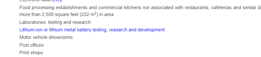

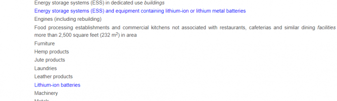

According to the 2024 IBC, and the IFC, and the code change proposal that prompted the new guidelines, an F1 using these materials and processes will be an F1, no matter the quantities. The FPE advised that in his opinion, based on these codes, the Li in this process is not "considered" a hazardous material. This is where I get a little puzzled, because in the 2024 IFC it is listed in the user notes to ch. 59, and in appx. E as a flammable solid. So my take away is that it is a flammable solid, but that the '24 codes do not consider it's use as a flammable solid that would prompt an H occupancy when the uses listed fall under the classifications for B and F1.
Here is a screenshot of the '24 IBC for B:
Here is the F1:
