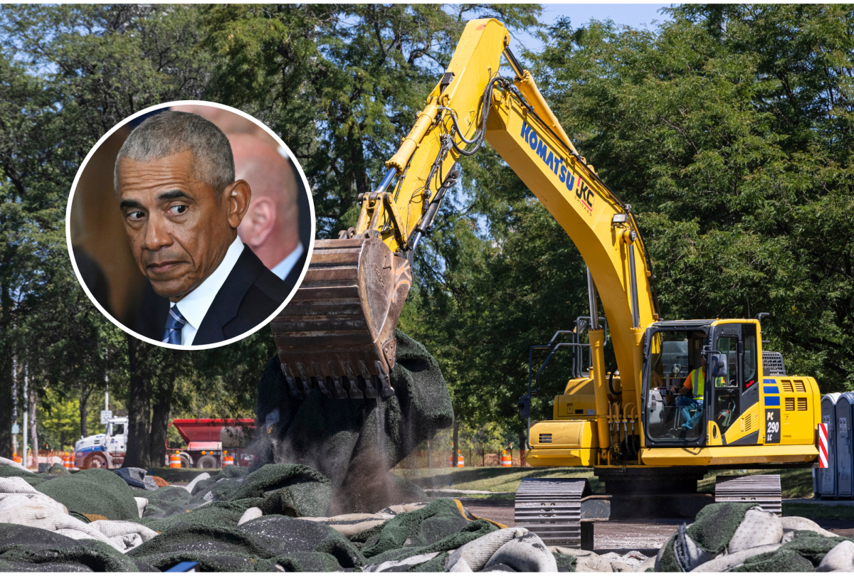

Concrete subcontractor is suing the structural engineer, Thornton Tomasetti, alleging racial discrimination and unreasonable interference in performing their work.
Thornton Tomasetti is one of the best structural engineering firms in the world. They do major projects internationally. Anything is possible, but I find it difficult to imagine that they would act on the basis of racial bias on a project as visible as the Obama Presidential center. This could be a case to watch.
Most of Concrete Collective's "compensable costs" come from loss in labor productivity, which the lawsuit says comes from the "unexpected" project specifications, prevention of "logical flow of work" as well as the "lack of mechanical, electrical and plumbing design coordination."
I fail to see how they can blame lack of M/E/P coordination on the structural engineer. That's a real stretch. As for the "unexpected" project specifications -- I wonder if they were created after the concrete sub had signed a contract, or if the concrete sub assumed some lesser standard specifications and was then caught by surprise when they actually read the specifications they had agreed to follow.

The lawsuit alleges that Thornton Tomasetti made an "improper and unanticipated decision to impose rebar spacing and tolerance requirements that differed from the American Concrete Institute standards," which, in addition to "Thornton Tomasetti's excessively rigorous and unnecessary inspection and Request for Information process," resulted in "millions of dollars in losses to II in One and Concrete Collective."

On a project of that size and prestige, the specs won't merely be assumed. They will be clearly established in the spec book, as will the RFI process. And if the engineer's preferred spec exceeds ACI standards, that is irrelevant; the contractor has to follow the contract documents. If they didn't anticipate the stricter specs, it's either because (A) they never read the spec book and/or took it seriously, (B) the spec wasn't yet issued at time of bid, in which case the contractor had an opportunity to ask for a change order to cover work associated with the more stringent specs; or (C) the general contractor failed to provide the specs to the sub prior to bid, in which case the GC would need to eat the sub's change order.
Likewise, inspection would only delay the project if (1) inspectors were unavailable upon reasonable request (legit change order), or (2) the contractor failed to call for inspection in a timely manner (not a change order), or (3) the workmanship repeatedly failed to make spec.
The only way a contractor can blame the RFI "process" is if they didn't take seriously the part in the specs where it says how many days the engineering firm has to respond to RFIs. Most engineers will be responsive to field requests, but when they sense the contractor is abusing the process, or using RFIs in lieu reading the plans closely for themselves, an engineer may not be inclined to fast-rack responses quicker than the contractual requirement.
