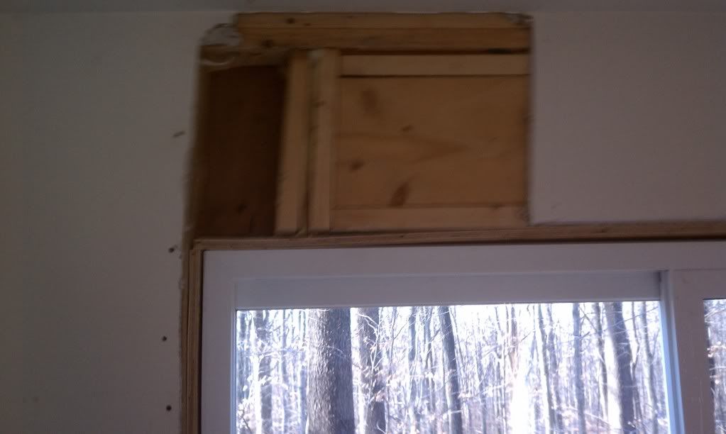

Was there for an electrical service inspection only. Not my jurisdiction, covering an area that does not have an electrical inspector. This is a load bearing wall that supports the floor above and a roof load (we are 40# gsl)
I told the contractor that this is a problem and to consult with the AHJ on this.
He told me it was not a problem and there was no need to fix it or pull a permit for a "cosmetic" change. The only reason I was even called is because without a cut in card, there is no power......

At least it's over the fixed panel. The tempered glass will take it! :? Not!

think structural double top plates, structural rim joist on floor#2, should pencil out! wheres our resident engineer george?:mrgreen:

That should'nt be allowed to stand and go unchallenged, because I suspect it won’t for long, without problems. Creep, settlement, joint movement, etc. will all take their toll. And, whether the guy likes structural advice or not from an electrical inspector, he sure needs it.
Surprisingly enough, something like that might stand for some time before it shows up as a problem. As mentioned by Pwood in post #5, any plywood sheathing, and 2nd floor framing including double top wall plate, rim joist, floor sheathing and joists, and the 2nd floor sole plate, if properly nailed together act as a pretty effective deep beam to span that opening. They are just not something any respectable Structural Engineer would hang his hat on, except in an emergency or for a short period of time. And then, only after careful inspection of the existing conditions to see if he felt this might work for a short time. I have seen 30 or 40' long exterior bearing walls continue to support floors and roof without much sag, after the found. wall below failed inward, into the basement. Full snow load did not exist at the time.
What kind of a finished frame is 1/2 or 5/8" plywood for a 6' sliding door system? The bend in that plywd. isn’t just from the wall loads above or the rest of the head joint would be closed too, and the header would be rotated down also. There isn’t much evidence that that header was sized right or put in correctly in the first place. Was there a cripple or jack stud in the first place, why the double common or king studs, the fit-up and joinery looks awful. Well, I guess that’s why they call it rough framing.
Looks like it was originally built with a 5' slider. At some point someone decided they wanted a wider door and cobbled this in. I'm guessing that they drove shim shingles into the gap between the header and plywood jamb in an effort to prevent the header from sagging. I think this falls in the category of "really? What the --ll are you thinking"?
Looks like it was originally built with a 5' slider or french door. At some point someone decided they wanted a wider door and cobbled this in. I'm guessing that they drove shim shingles into the gap between the header and plywood jamb in an effort to prevent the header from sagging. I think this falls in the category of "really? What the --ll are you thinking"?

Mr Roberts, we have a rim joist that is carrying floor and roof loads, that was once supported by studs (albeit incorrectly), that were cut, and are now supported by a sliver of plywood shim and a door frame. Does it really take engineering calculations to back up that there is a problem with the load path?
Actually all I have to do as the inspector is identify that the installation does not meet the IRC and that they need to modify to meet IRC requirements. If they do not wish to make the corrections it is up to the owner/contractor to enlist the services of an engineer and prove that the nonconventional installation is structurally satisfactory.

Well I guess I would agree with George that the services of a structural engineer are required if they want to leave the door and header as it is. If they modify to meet IRC requirements no engineer required.
