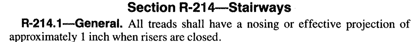

My guess is that one of the model codes had a 1 1/4" limit before ADA, and it just got carried over into the IBC.

For those wondering which code might have been the source, 1996 BOCA has a limit of 1 1/4 inches.
