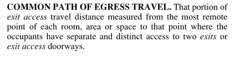

I understood that for "Exit Access Travel Distance," but I wasn't sure if it also applies to "Common Path of Travel Distance." Regardless, it seems quite vague to me. Perhaps I'm overthinking it.
Sometimes checking the definitions will help you when over thinking something
COMMON PATH OF EGRESS TRAVEL. That portion of exit access travel distance measured from the most remote point of each room, area or space to that point where the occupants have separate and distinct access to two exits or exit access doorways.
