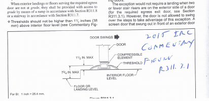

I am curious if you count a threshold as part of the riser at a door or do you measure to the landing on the other side of the door. For a single step at a door I thought that you measured from the bottom landing to the top of the threshold with a maximum of 7". But reading 2018 IBC 1010.1.7 "Thresholds", exception 1, (for R-2 exterior door, non accessible, not a means of egress, the threshold can be 7-3/4 high which makes me think that I should only measure to the landing on the other side of the door since 1003.5.5 "Elevation Change", exception 1 requires a 7" max risers at R-2 non accessible exterior doors.
Unfortunately there is no definition of a riser in the IBC.
So is a threshold part of a riser or not when on top of a step?
For structures under the IRC, see the following. Take note that under these sections you do measure to the top of the threshold.

Thanks classicT and tbz but the language in the 2021 and 2018 IBC seems a lot different. I found out this project was permitted under 2015 IBC.
I think I'll use 1010.1.7 which says thresholds at swinging doorways shall not exceed 1/2 above the finished floor or landing for swinging doors.
1002.5 exception1 allows a single 7" step for R-2 occupancies.
So the total rise can not not be more then 7-1/2" from the bottom landing to the top of the threshold for these egress, non accessible doors. Does not say anything about which way the door swings.

There is no mention of a riser in 311.3.1
R311.3.1 Floor elevations at the required egress doors.
Landings or finished floors at the required egress door shall be not more than 11/2 inches (38 mm) lower than the top of the threshold.
Exception: The landing or floor on the exterior side shall be not more than 73/4 inches (196 mm) below the top of the threshold provided that the door does not swing over the landing or floor.
Where exterior landings or floors serving the required egress door are not at grade, they shall be provided with access to grade by means of a ramp in accordance with Section R311.8 or a stairway in accordance with Section R311

So the arguement is that the elevation change from the dwelling floor to the exterior landing is a stair. I have established that a single riser stair is also a stairway.

There is a floor and a landing with no treads in between. No flight. No stairway. No riser.

A stairway can have a single riser. If the elevation change at the door between landings is a single stair riser well then.... you have a stairway.
A stair, not a stairway, can have a single riser by your code cut and pasted. A stairway is a flight, with more than riser.
I was asking about a R-2 non accessible exterior means of egress door to a deck in the 1015 IBC.
So if the max. 7-1/2 step up from the deck to the threshold top is a change of elevation and not a stairway or a riser but a just a floor on the bottom and top but no landings or treads and does not matter which way the door swings this would be allowed per the following two sections:

Notice exception 1 is not calling it a elevation rise, or a stair or a riser but just a threshold height. But I can't use this because what I am looking at is a m.o.e

the normal path of egress travel on the stair.
No mention of which way the door swings anywhere here.
Notice that exception 1 is calling it a step, not a stair but is still calling for a riser, and 2 is calling it a stair with a single riser. I find this very confusing.
The commentary refers to "the required egress door". Does the mean other non-required egress doors dont have to comply? A 10" rise with outswinging door is ok?
I have been waiting for this thread to get to this question. I have struggled with the IRC language. I have not permitted doors to swing over any stair but specific to this thread I am talking about the "other" exterior door based on the following:
R311.3: a landing is required on each side of an exterior door.
R311.3.2: (subsection to R311.3) the floor or landing is permitted to be 7 3/4" below the threshold (does not stipulate which side of the door)
exc. to 311.3.2: a top landing is not required as long as the exterior side of the door has a stair 2 risers or less and the door doesn't swing over them.
I struggle because landing is not defined as a clear space without a door, though that is the way I have interpreted it. I also struggle because although the exception clearly indicates that it is the exterior landing that can be 7 3/4" below, it is not specified in the code itself, and says that the top landing is not required (Which is where I get the interpretation that the landing can't have a door in it.)
It seems like better language could be written, or maybe a definition for landing. I'll chew on this one....again.
