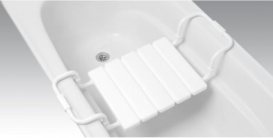

Bathtubs are required to comply with standards. IPC Section 407.1. Manufacturers working to those standards are going to have model lines that will cover certain sizes (that are common to the industry). If the proposed tub doesn't comply with one of those standards, then it is an alternative approval situation (Section 105.2). ICC A117.1-2009 Section 610.2 indicates that the top of a permanent seat (at the head end of the bathtub) must be 17 to 19 inches above finished floor. If it is a portable seat (in other words, there is not a seat area at the head end of the bathtub), 15 to 16 inches above the finished floor.
The OP asked where the code specifies minimum bathtub dimensions? For example what of a triangular shape tub in corner; do we determine the size from the allowable grab bar locations and clearances in reference to the bathtub?
Furthermore does the code specify bathtub rim height or just the seat height?
610.2 Bathtub seats
. The height of bathtub seats shall be 17 inches minimum and 19 inches maximum above the bathroom floor, measured to the top of the seat. Removable in-tub seats shall be 15 inches minimum and 16 inches maximum in depth. Removable in-tub seats shall be capable of secure placement. Permanent seats shall be 15 inches minimum in depth and shall extend from the back wall to or beyond the outer edge of the bathtub. Permanent seats shall be positioned at the head end of the bathtub.

HForester and Francis Vineyard: The code specifies seat height relative to the tub floor, NOT relative to the tub rim.

Concerning Yikes' post, Monday at 5:37 PM: "The code specifies seat height relative to the tub floor, NOT relative to the tub rim"
No, relative to the floor outside of the tub. As previously provided...A117.1 says:
610.2 Bathtub seats. The height of bathtub seats shall be 17 inches minimum and 19 inches maximum above the bathroom floor, measured to the top of the seat.
This arrangement doesn't get it done correctly:
HForester, you are correct, it is 17-19" above bathroom finish floor, not the bathtub floor.
That still doesn't prohibit a very tall or very short rim of bathtub.
