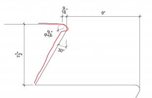

Hi all,
We're having a code disagreement in our office I was hoping you could weigh in on. Does the stair design in the image attached meet the IRC 2021 (Connecticut)? The intention is for the stair to have a modern design, with no squared off nosing projection, with a tread depth less than 11".
The debate centers around whether the radius of the tread (R311.7.5.3 Nosings) and/or the slope of the riser (R311.7.5.1 Risers) negate the need for a nosing projection?
  • One person says "If you have a nosing, you meet code. Why is there an exception for a slanted riser if you are required to have a nosing in all cases. The slanted riser becomes the nosing."
  • The other person says "the nosing projection requirement is completely separate from the riser requirements and a nosing is not achieved by a slope or radius. It’s just a slope or radius, not a projection. Adding a slope doesn’t negate the need for the projection. Making the tread 11” is the only exception that absolves you from needing the nosing projection. The code also states that the riser is from the underside of the nosing, meaning a nosing would be present."
Thanks in advance for your help.

The difficulty in the OP arises because R311.7.5.3 does not define how to measure the "nosing projection." Note that "nosing" is defined in Chapter 1 as "The leading edge of treads of stairs and of landings at the top of stairway flights," so one of the two points to use in the measurement is specified, but the other point is not.
This is in contrast to R311.7.5.1 and R311.7.5.2, which clearly define how to measure riser height and tread depth. Which are 7-1/2" and 9", respectively, in the diagram in the OP.
It is clear that R311.7.5.3 does require a "nosing projection" between 3/4" and 1-1/4", as the tread depth is less than 11". So the only hope for considering the profile in the OP to be compliant is to say that as the nosing projection measurement is not specified, you have the leeway to choose where to measure it from. If you choose to measure it at the point on the riser that is 2-1/2" below the surface of the tread above, then you'll get a nosing projection of about 0.96", which would be compliant.
Doing that is arbitrary for the profile in the OP. You could, of course, alter the profile slightly to introduce some additional curve in the correct location and use that change in shape as a less arbitrary justification for where to measure the nosing projection to.
Cheers, Wayne

If you create a little more of a nosing but still slant back … would that be a workable compromise? (That’s supposed to be a continuous radius).

Why is a "workable compromise" even necessary when the stair shown in the original; post isn't a code violation?
YC,
So here is the question that you are saying does not exist and note as compliant:
Definition of a nosing CT IRC: Chapter #2: "NOSING. The leading edge of treads of stairs and of landings at the top of stairway flights."
So, per the definition the forward most point within the 9/16" radius is the leading edge and the same goes for the 1/2" bevel.
  • A nosing is required for a tread with a depth of less than 11-inches.
    • The OP's post is 9-inches so a nosing projection is required.
    • The nosing is required to be a minimum of 3/4" to a maximum of 1-1/4"
    • In the diagram in your opinion where is the 3/4" - 1-1/4" range defined with start and stop points?
  • With the radius of the nosing being 9/16" the transition point from the radius to the slant begins prior to the 3/4" minimum being met and continues past the maximum 1-1/4" point when measured from the leading edge.
    • So for a tread under 11-inches please explain your defined start and stop points for the required nosing measurements to be taken at?

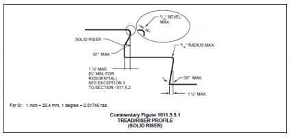

All I can tell you is that the nosing profile shown in the opening post is specifically shown in the 2021 IBC Commentary. The only part about the stair shown in the OP is that the nosing overhang appears to exceed 1-1/2".
I believe I agree with Tom in that the nosing can be the first 3/4" and then it is a sloped riser face beyond that.....Remember, the nosing and the sloped risers are separate code sections even though they are the same feature at times....The language probably needs to be clarified and maybe homogenized between IBC and IRC to help with the confusion....
In the diagram you posted, the nosing projection is measured in both cases to the rear-most point of the riser face. [While this is a natural choice, it is not actually specified in the IRC.] Applying that methodology to the profile in the OP gives a riser projection of about 3-3/4". So I don't think that diagram helps support the idea the OP's profile is compliant.
Cheers, Wayne
Yankee,
Look at what you posted it is not the same.
What you posted notes the 1.25" maximum, and notes 30Deg is the max slope. But if you actual measured that diagram you would see that its not 30 degrees.
it is only 10.29 degrees aprox...
