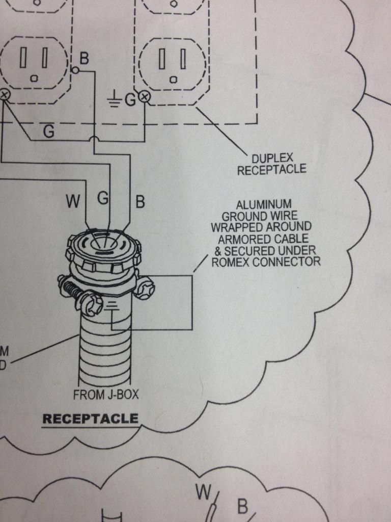

Dental facility needing to meet the requirements of NEC 517.13(A). This is how Belmont Dental wants me to meet that requirement. Whats wrong with this pic?

So, can you ground in series, one out let to another instead of seperate pigtails, and the wire wrapped around the cable seems ganky.
Shouldn't the ground go directly to to the panel or wire?

I'll take a stab, don't have the book in front of me, but don't medical recepts require the ground to be inside the flex? Or, solid EMT? Flex, MC don't cut it?

FB...the "green" MC works....the sheath needs to be listed as a grounding? conductor, the Romex connector would not be listed for grounding connector.....But I thought that was 514.....now you are going to have to make me open a book..
517.13 Grounding of Receptacles and Fixed Electrical
Equipment in Patient Care Areas. Wiring in patient care areas shall comply with 517.13(A) and (B).
(A) Wiring Methods. All branch circuits serving patient care areas shall be provided with an effective ground-fault current path by installation in a metal raceway system, or a
cable having a metallic armor or sheath assembly. The metal raceway system, or metallic cable armor, or sheath assembly shall itself qualify as an equipment grounding
conductor in accordance with 250.118.

That drawing in the original post is full of errors!
The first one is they show a MC /AC connector but refer to it as a romex connector
The second one is they refer to an aluminum "ground ground wire" to be wrapped around the cable sheath. It IS NOT A GROUND WIRE ! It is a bond wire as the cable is armored cable ( ac cable). As per the manufacture it can be just cut off or wrapped around the cable sheath.
The third one they do not show the box being grounded with the ground inside the ac cable.

I was also a bit surprised that a company that supplies equipment for a 517 environment would publish that detail.
It's a metal box, the equipment is here. I'll take some pics and post them later, how this stuff got listed is beyond me.
Thanks Chris....I was just playing devils advocate, if I EVER got that level of detail on a plan I might question it, but I would just check for the bond in the field....Usually I would tag the plan review with something like..."Wiring must comply with NEC 517"....and then they will still use the wrong wire from the switch to the light fixtures....
