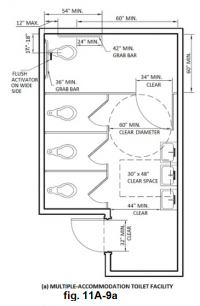

Under Housing Accessibility, Chapter 11A, Figure 11A-9A, page 492, a picture of a Multiple-Accommodation Toilet Facility is shown. Chapter 11B does not show this picture.
Are we supposed to use the same information for a commercial building?
Thank you.
Thank you.
