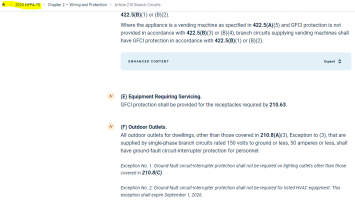

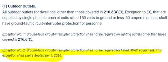

Can you provide a section number please.
My California Electrical Code has this:
210.8 Ground-Fault Circuit-Interrupter Protection for Personnel. Ground-fault circuit-interrupter protection for personnel shall be provided as required in 210.8(A) through (F). The ground-fault circuit interrupter shall be installed in a readily accessible location.
(F) Outdoor Outlets. All outdoor outlets for dwellings, other than those covered in 210.8(A) (3), Exception to (3), that are supplied by single-phase branch circuits rated 150 volts to ground or less, 50 amperes or less, shall have ground-fault circuit-interrupter protection for personnel.
Exception: Ground-fault circuit-interrupter protection shall not be required on lighting outlets other than those covered in 210.8(C ).

Up.codes has a version of the CEC that I am not familiar with.
What source do you use for the CEC?
I'm not a huge fan of upcodes, I rely on the hard copy of my code books when it counts, purchased as a set through ICC, and I personally insert the supplements/errata. I will admit though that for casual looking it is easier to browse on the computer. So far I have not found any discrepancies. I also go to the building standards commission website periodically to check their published versions for new errata and supplements. It is my understanding that what they publish on their website is the most definitive source.
Well I have to take my last statement back, just double checked and discovered that this is indeed an upcodes discrepancy.
"This requirement shall become effective on January 1, 2023, for mini-split-type heating/ventilating/air-conditioning (HVAC) equipment and other HVAC units employing power conversion equipment as a means to control compressor speed."
Does not exist in my hard copy, and does not exist in the BSC published version. I would say that this is not valid. I am very curious where this came from.
